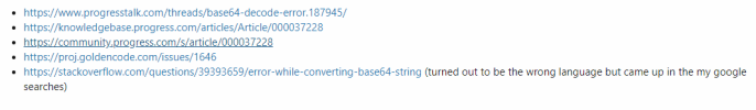

I've looked a various progress articles and a Progress Talk thread on the same issue. None of the suggestions have helped hence a new thread.
