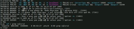

sorry for take so much times to reply . ok i tried to look on " /etc/services" i found a group of 4gl-services under the commet #Services progress (see screen capture #1:) and i added the SQL-services just after. I stop the database using my shutbbj script then i tried to start one ( the fbbj92)
.i moved where the fbbj92.db file locate the run this:
proserve fbbj92 -n 700 -Mn 61
proserve fbbj92 -m3 -Mpb 40 -Ma 10 -Mi 1 -H localhost -S fbbj92-srv -ServerType 4GL -minport 10000 -maxport 10099
proserve fbbj92 -m3 -Mpb 20 -Ma 10 -Mi 10 -H localhost -S fbbj92-srvsql -ServerType SQL -minport 10200 -maxport 10299
then i look at sqlsrv2 process . i i found nothing running
ps : i got a warning that i didn't gave a value for the option -e.

Even if there hadn't been any errors with the proserve commands, initially you wouldn't see any sqlsrv processes. The proserve commands start database brokers, which are _mprosrv processes. Remote servers are started on demand, when a remote client connects to them. The SQL server executable is _sqlsrv2 (assuming it exists in 9.1A!). You won't see such a process until a SQL client connects to the SQL broker, causing a SQL server to be spawned.
I think it could work without the "-ServerType" (to avoid the "warning") , you always specify the good "-S " for your connection so they will be done on the good dedicated broker.
"-S fbbj92-srv " for the 4GL connections and " -S fbbj92-srvsql " for the SQL connections ,

Like the others said, 9.1a apparently doesn't have the -ServerType option. Sorry about that, I got tricked into thinking that it must be there by the log message "Ce broker supporte et le groupe de serveur 4GL et SQL. (8865)"
Have I mentioned that you really ought to upgrade this system?

So just remove the "-ServerType 4GL" and "-ServerType SQL" parameters but continue to start distinct brokers.
Even though you cannot enforce it with -ServerType, you still want to have two distinct brokers, one for 4gl and one for sql. You will need to enforce it by not telling the 4gl users about the SQL port and vice versa. So long as users respect that one port is for 4gl users and the other is for SQL users you will be ok. A classic case of "security through obscurity".
If they get mixed you run the risk that users will be unable to connect because users of the other connection type have consumed all of the available "remote servers" (once a remote server is launched it supports just one type of connection).

it works ! i typed these:
proserve /d4/base/fbbj/fbbj92/principale/fbbj92 -n 700 -Mn 61
proserve /d4/base/fbbj/fbbj92/principale/fbbj92 -m3 -Mpb 40 -Ma 10 -Mi 1 -H localhost -S fbbj92-srv -minport 10000 -maxport 10099
proserve /d4/base/fbbj/fbbj92/principale/fbbj92 -m3 -Mpb 20 -Ma 10 -Mi 10 -H localhost -S fbbj92-srvsql -minport 10200 -maxport 10299

PascalMBOUM
should i change the port on the SQLexplorer.properties file (replace this one in screen capture with with the one i use for sqlserver type port 2262 ?)
thanks!
TomBascom
Curmudgeon
This stuff was all 25 years ago... our memories are "dim".
I believe that the properties file is just defaults. The -S that you provide on the sqlexp command line will override the one in the properties file.
Speaking of command lines, your most recent example is not properly formed. You are missing "-db fbbj92" and have, instead, provided the full path for some unknown reason. The command line should be:
sqlexp -char -db fbbj92 -S 2262 -H localhost -user root -pass ""
If that still results in an error the sqlexp.log might tell us something interesting. (You might want to truncate that before trying again so that we get a clean log.)
Stefan's point about ODBC vs JDBC might also be relevant. You could test that idea by trying to connect using an ODBC driver from a Windows desktop somewhere.
