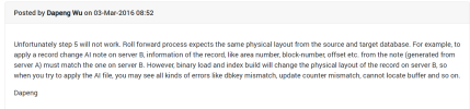

Sorry, I do not think it will work...
The backup will restore each records in its current block number (it does not eliminate the empty blocks)
You will have the same number of blocks in each areas (even if you could use different extent size or number ).
If you run an idxbuild you will lost the ability to rollfowrward
You should consider alternatives like dump&load,PRO2, ...
