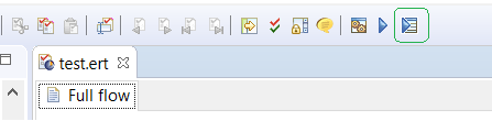

The rule trace is a new function in Corticon studio that you can access when running rule tests. Essentially, you can run rules tests with rule tracing enabled.
You simply use the button highlighted below:

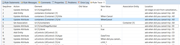

When you run your tests with rule tracing enabled you get an additional view indicating which elements were changed, what was the value before and after any rules changed any attributes. You can sort any columns to quickly focus on specific areas.
Here is an example of the rule trace view and its content.
This is all very nice, but the key feature is to be able to double click on any attribute changes (any row) to find the root cause, that is the exact rule that changed the attribute. This is what enabled us to troubleshoot our problem in no time.

- We ran the full ruleflow with rule trace.
- We sorted the rule trace view by the column Element. This allowed us to quickly find the row where UI.done was set. In our case, there was only one location where the flag was set, as outlined below (Row sequence 7).
- We double clicked on that row. Corticon studio brought up the culprit rulesheet in the rulesheet editor. Thus, we immediately had the rulesheet name as well as the exact rule action that resulted in this attribute being set.
Now in our case, it was simple to discover that this rulesheet was executing because we had set a filter incorrectly. So, it was not that the rule at line F was wrong, it was simply that the entire rulesheet should not have executed. We fixed the filter to execute this rulesheet on the proper stage value.
