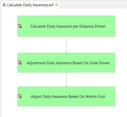

In Corticon, business analysts work with two main artifacts to create a decision service, rulesheets and ruleflows. Additionally, Corticon provides testing at the decision service level (system testing) or the rulesheet level (unit testing).
In the rulesheet, the analysts express the rules conditions and associated action. In the ruleflow, they express how all rulesheets are connected to create a decision service.
In this simple example, we see how a decision service is decomposed into three independent rule sets (three Corticon rulesheets). There are many advantages to such a decomposition. For one, this allows for scaling as each business analyst can work on their specific domain independently.
Additionally, the ruleflow—as its name indicates—specifies the order of execution.
Additional constructs are available to modelers. Of course, a ruleflow can specify different branches to execute depending on business data. For more complex projects, a ruleflow can be decomposed into subflows for better organization and scalability.

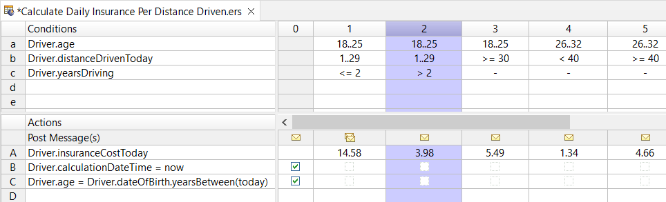

The core of the business rules is written in a familiar spreadsheet like the interface shown in the following image.
For example, rule 2 specifies that a driver, aged 18 to 25 with 2 years of driving experience, has driven today a distance in the range of 1 to 29. All that sums up the cost to be 3.98. Additionally, for all cases (column 0), the business analyst records the computation date and computes the driver’s age.

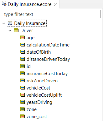

One key aspect of enabling business specialists to author business rules is to provide a common understanding of the data available for processing as input and output.
Corticon provides a view of the enterprise data in an easy-to-work way for the business specialist. If needed, it provides an optional mapping between the actual data and the business representation. This allows business users to work with names or terms that are more familiar to them without impacting the integration of the decision service into the rest of the application.
Typically, as an architect or application designer, you may have to provide this vocabulary to the business specialists.
Here is an example view:
Note that this is an oversimplified vocabulary for illustrating concepts. In practice, Corticon supports very complex vocabulary with very deep relationships (1 to 1, 1 to n or many to many). It is common for us to see a vocabulary containing thousands of items; that’s why we have a filter capability that allows the user to narrow complex vocabulary down to area of interest.
Example Ruleflow
