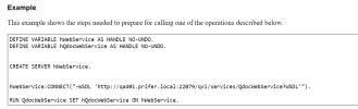

However, when I try to convert it to ABL/4GL code it doesn't work. I'm 100% doing something wrong but i can't seem to find it. I already talked to some colleagues of mine but nobody seems to find the problem.
I used the 'bprowsdldoc ' tool to get the following information:
(Only procedure/method found present in the .wsdl file)
Code i'm using:
    DEFINE VARIABLE hWebService              AS HANDLE   NO-UNDO.
    DEFINE VARIABLE hQdocWebService          AS HANDLE   NO-UNDO.
    DEFINE VARIABLE part                     AS LONGCHAR NO-UNDO.
    DEFINE VARIABLE processQdocMessageReturn AS LONGCHAR NO-UNDO.
    DEFINE VARIABLE err                      AS LOGICAL  NO-UNDO.

    CREATE SERVER hWebService.
    hWebService:CONNECT("-WSDL 'http://qad01.prifer.local:22079/qxi/services/QdocWebService?WSDL'") NO-ERROR.
    RUN QdocWebService SET hQdocWebService ON hWebService.
    part = getBody().
    RUN processQdocMessage IN hQdocWebService(INPUT part, OUTPUT processQdocMessageReturn) NO-ERROR.

Errors i get:
The postman doesn't have any header as well. I can paste it to other request or even SOAPUI and it works just fine.
I've already used this code to consume several SOAP services but the other ones were a lot simpler (ex: 1 string input, 1 logical output).
Can anyone find the error?

Do you know how can i make progress not do this?
I also can't have "soap-env" instead of "soapenv" in the request. doesn't work if i try that in the postman....
patelspam
Okay i got a TEMPORARY fix.
Apparently PROGRESS adds automatically the 'envelope' and 'body' to my request. but since it does that, it "destroys" what i want to send and makes it impossible(for now) to do it this way.
So i did the following:
DEFINE VARIABLE responseLCWSDL                          AS LONGCHAR  NO-UNDO.
PROCEDURE qad-POST:
    DEFINE INPUT PARAMETER inputWSDL AS CHARACTER NO-UNDO.
    DEFINE VARIABLE oRequest   AS OpenEdge.Net.HTTP.IHttpRequest  NO-UNDO.
    DEFINE VARIABLE oResponse  AS OpenEdge.Net.HTTP.IHttpResponse NO-UNDO.
    DEFINE VARIABLE hXMLHandle AS HANDLE                          NO-UNDO.
    oRequest = OpenEdge.Net.HTTP.RequestBuilder:Post("-WSDL '":U + inputWSDL + "?WSDL'":U, qad-getQueryCostCentreRHBody())
                         :ContentType('text/xml;charset=UTF-8':U)
                         :AcceptAll()
                         :AddHeader('SOAPAction':U, '"#POST"':U)
                         :REQUEST NO-ERROR.
    oResponse = OpenEdge.Net.HTTP.ClientBuilder:Build():Client:Execute(oRequest) NO-ERROR.
    IF oResponse:StatusCode <> 200 THEN
    DO:
        MESSAGE "http error: ":U oResponse:StatusCode VIEW-AS ALERT-BOX.
        RETURN "error":U.
    END.
    hXMLHandle = CAST(oResponse:Entity,OpenEdge.Core.WidgetHandle):VALUE NO-ERROR.
    hXMLHandle:SAVE('LONGCHAR':U,responseLCWSDL) NO-ERROR.
END PROCEDURE.
Since i couldn't map it correclty (because of the scuffed tags the XML is using) i then created a dynamic DATASET and used 'READ-XML' with the longchar i get from the response. Then i loop the records and then I can do what i want with the data.
This last part might get a bit slow but i already tried with a XML file with more than 70k lines and only took about 2seconds (and it was in a over-used server, so it's not bad at all).
If anyone happens to encounter this error and happens to fix it the normal way please let me know.
Thanks again.
