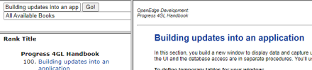

You may find this useful for working with temp-tables in a browse - search for 100 - Building updates into an application:
