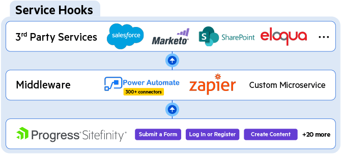

So, integrations have always been a Sitefinity staple. To put it all in context, webhooks have been doing a good job of integrating external apps and services through a collection of exposed system events. Somewhat of a downside of webhooks though, is that they’re too technical. A tool for devs to play with, rather than business users.
Now, Service Hooks are also event-based low-code integrations, but events follow a business-friendly naming convention and cover a wider range of use cases—with the option to create custom triggers or choose between more than 20 events available right out of the box.
Whenever an event takes place, a service hook will relay the outcome to a proprietary microservice or middleware of choice. The said middleware can be a low-code development platform such as Power Automate or Zapier. Power Automate alone has a set of over 300 connectors—that’s three hundred third-party software solutions Sitefinity can integrate with.
Essentially, Service Hooks make it that much easier to have a tightly connected ecosystem of key marketing automation services and data solutions communicating seamlessly with Sitefinity.

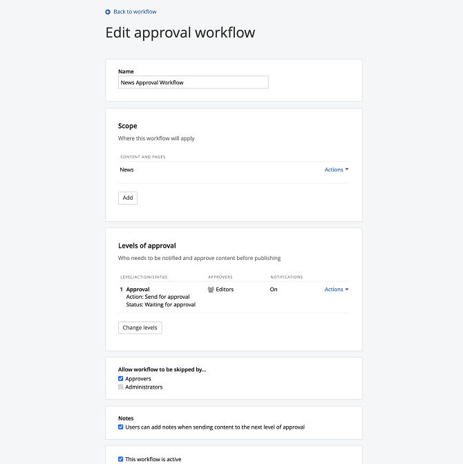

Set Up Approval Workflow
Let's start by setting up a one-level approval workflow per the instructions in the Sitefinity documentation. Define the scope of the Approval Workflow to be "News". Once we have it set up, the Author should get approval from an Editor to have the content published.

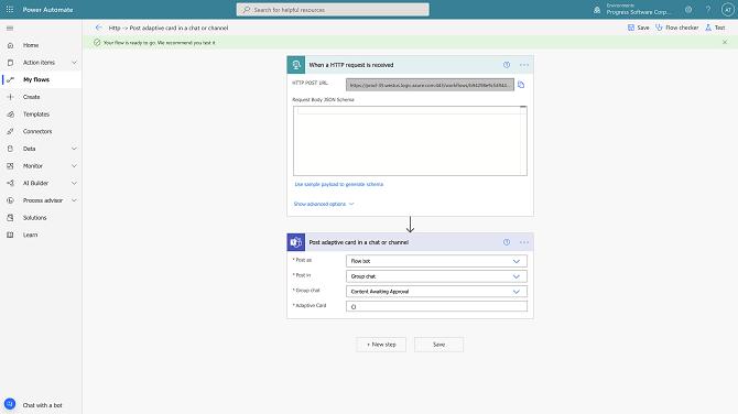

- Create "Automated cloud flow." Skip the wizard. Refer to this article to get familiar with the "Automated cloud flow" creation.
- Add a trigger by searching for "When an HTTP request is received" and then select it.
- Add a new step "Post adaptive card in a chat or channel."
- Select to post as "Flow bot."
- Select to post in "Group chat." You could easily have a separate channel instead of a group chat.
- Select the "Content Awaiting Approval" group chat we already created. Here is a small tip: there should be at least one message in the chat for it to appear in the dropdown.
- Add "{}" in the Adaptive card field for now. We will get back to it later.
- Save the flow.

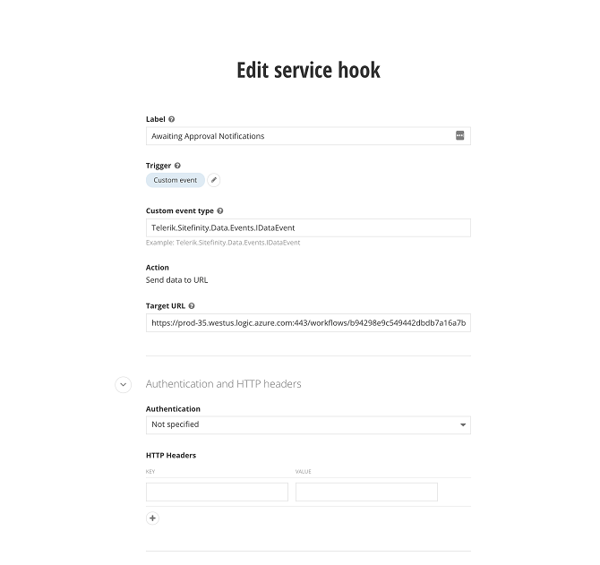

- Open the Sitefinity backend and navigate to Administration >> Service Hooks.
- Create a new service hook.
- Add "Awaiting Approval Notifications" as a label name.
- We want the Power Automate flow we created to be triggered when a content item (News item) is submitted for review. There is no such Service Hook trigger out-of-the-box but, as usual, Sitefinity provides a high level of flexibility. Select "Custom event" as a Service Hook trigger. To find it, you need to expand the initial set of triggers displayed by clicking on the "Show all triggers."
- Add the Telerik.Sitefinity.Data.Events.IDataEvent in the "Custom event type" field.
- Now switch to the Power Automate flow and expand the "When an HTTP request is received” field.
- Copy the URL and paste it in the "Target URL" field of the Service Hook.
- Save the Service Hook.

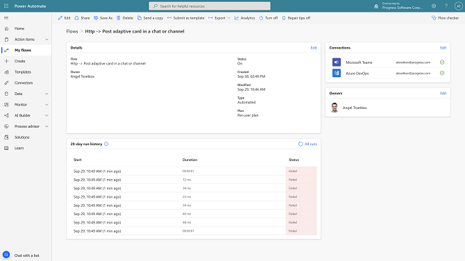

Go ahead and create a news item and submit it for approval. You will notice that your Power Automate flow was executed 8 times, and all of them are failed. There’s nothing to worry about.

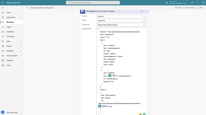

Complete the Teams Notification Setup
Let's complete the Teams notification step by configuring the Adaptive Card.
- Expand the "Post adaptive card in a chart or channel."
- Paste the following JSON in the Adaptive Card field and Save the flow:
"$schema": "http://adaptivecards.io/schemas/adaptive-card.json",
"type": "AdaptiveCard",
"version": "1.0",
"body": [
"type": "TextBlock",
"text": "Awaiting Approval",
"id": "Title",
"spacing": "Medium",
"horizontalAlignment": "Center",
"size": "ExtraLarge",
"weight": "Bolder",
"color": "Accent"
"text": "@{triggerBody()?['Item']?['Title']} is awaiting approval.",
"id": "acHeaderTagLine",
"separator": true
"actions": [
"type": "Action.OpenUrl",
"title": "Review",
"url": "https://demo.sitefinity.cloud/Sitefinity/adminapp/content/newsitems/@{triggerBody()?['OriginalEvent']?['ItemId']}/edit"

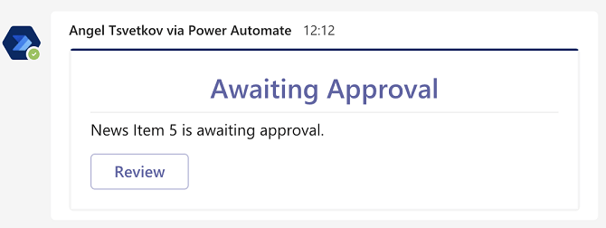

Go ahead and create a new News item and submit it for approval. Do that as an Author. I’ve got some good and some bad news: the Teams integration is working, but there is an adaptive card sent several times. Let's resolve that.

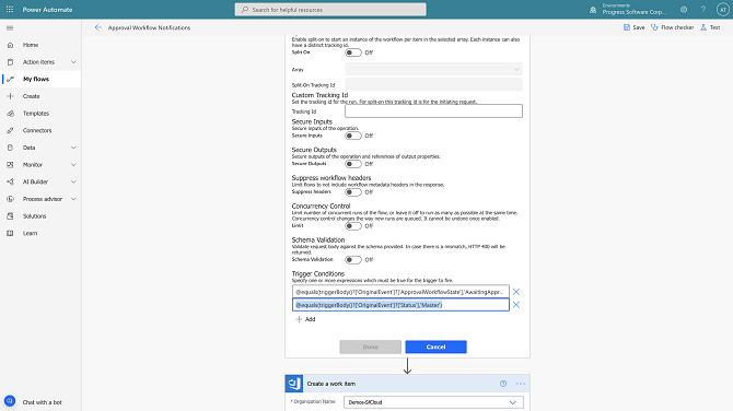

Configure the Power Automate Flow trigger
- Click the three dots icon in the "When an HTTP request is received." (first) step and click "Settings."
- Add the following 2 trigger conditions:
- @equals(triggerBody()?['OriginalEvent']?['ApprovalWorkflowState'],'AwaitingApproval')
- @equals(triggerBody()?['OriginalEvent']?['Status'],'Master')
The Settings should look like that:
Click "Done" and save the flow. Do the same test again by creating a new news item and send it for approval. If everything is fine, you will receive only one adaptive card.
Go ahead and click the review button. You should be prompted to the news item that is awaiting approval. You need to log in as Editor.

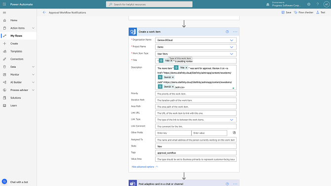

- Add a new step Azure DevOps >> "Create a work item."
- Select your organization name.
- Select the project name.
- Select a "User Story" as a work item type. This could be anything, even a custom type. In order for the created item to be visible on the Kanban board, it should be a user story or feature.
- Set the title as '"@{triggerBody()?['Item']?['Title']}" is awaiting review'.
- Set the description of the user story as:
• The news item "@{triggerBody()?['Item']?['Title']}" was sent for approval. Review it on
<a href="https://demo.sitefinity.cloud/Sitefinity/adminapp/content/newsitems/@{triggerBody()?['OriginalEvent']?['ItemId']}/edit">https://demo.sitefinity.cloud/Sitefinity/adminapp/content/newsitems/@{triggerBody()?['OriginalEvent']?['ItemId']}/edit</a>
• Replace "home" with your website url. - Expand the advanced options.
- Add "New" in the state field.

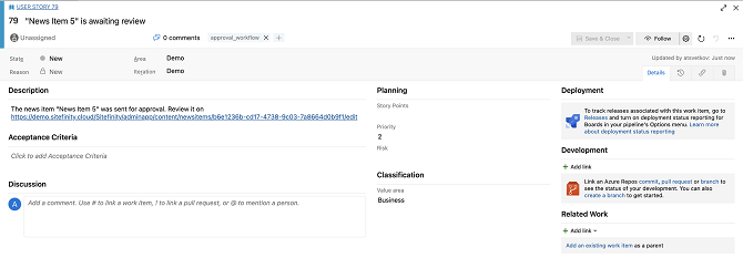

- Let's create the user story with the tag "approval_workflow" to flag the items produced as part of the approval workflow.
Save the flow, and let's create another news item as Author and send it for approval.
