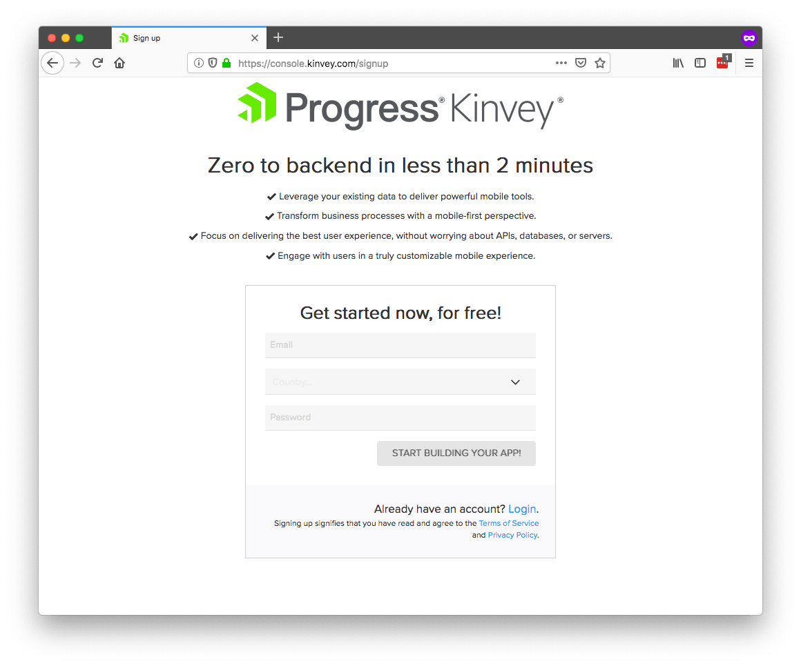

First things first, to use Kinvey, you first need to create a free Kinvey account. To do so, head to console.kinvey.com/signup and provide your email and a password to register.
After you have an account, Kinvey will prompt you to create a new app. You can name your app whatever you’d like, but if you’d like to follow along with this article, create a new app named Tasks. (You can create additional apps at any time.)

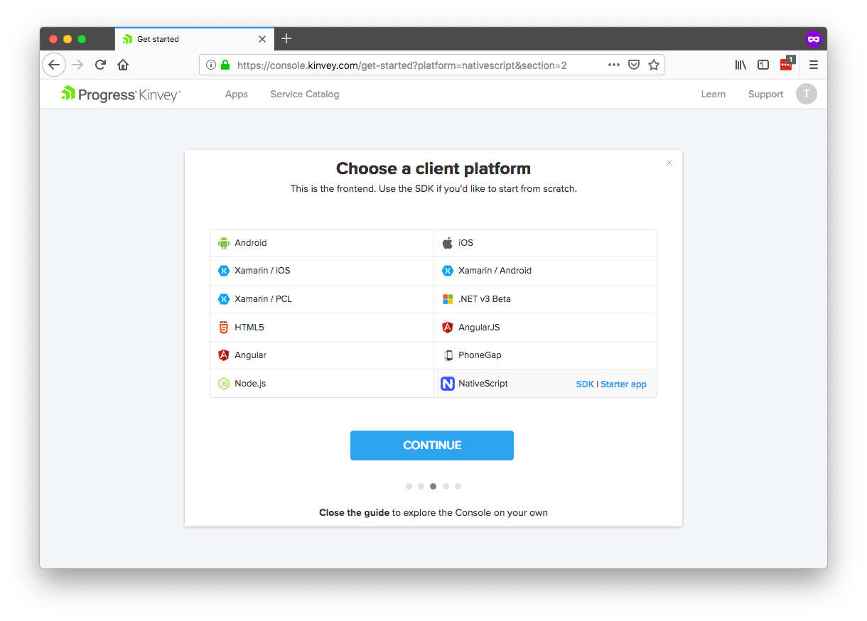

After you create your app, Kinvey will next ask which client platform you’d like to use.
You can use Kinvey on many different platforms (and switch between those platforms at any time), but for this article we’ll stick with NativeScript, so go ahead and select the NativeScript platform and click Continue.
TIP: Check out the Kinvey documentation to learn about using Kinvey in other environments, such as in your web apps.

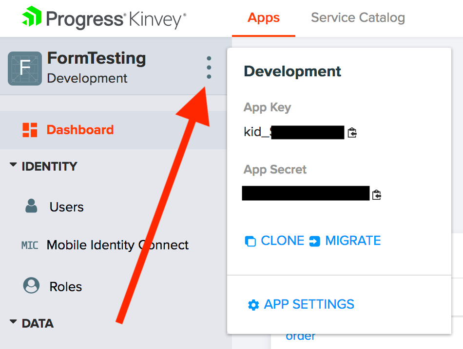

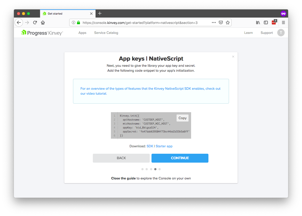

Finally, on the next screen, copy your app key and app secret, and paste them somewhere convenient. (If you do lose these keys, I’ll show you where to find them again later in this article.)
And with that, you now have your Kinvey account set up and a new app ready to go. We’ll return to Kinvey later to start to leverage its features, but for now, let’s shift over to getting your NativeScript environment ready.

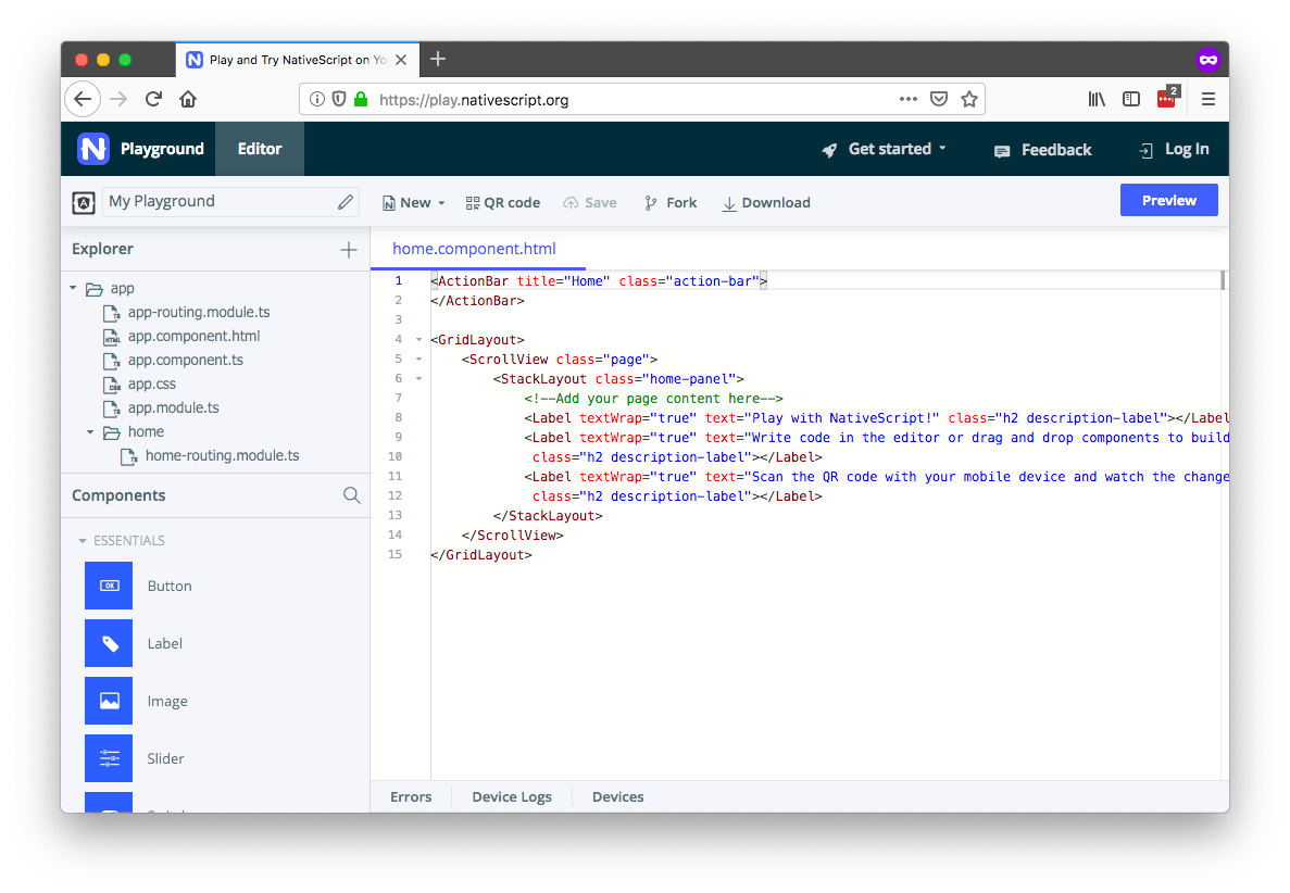

Go ahead and visit Playground in your browser of choice. You should see a screen that looks like this.

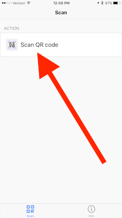

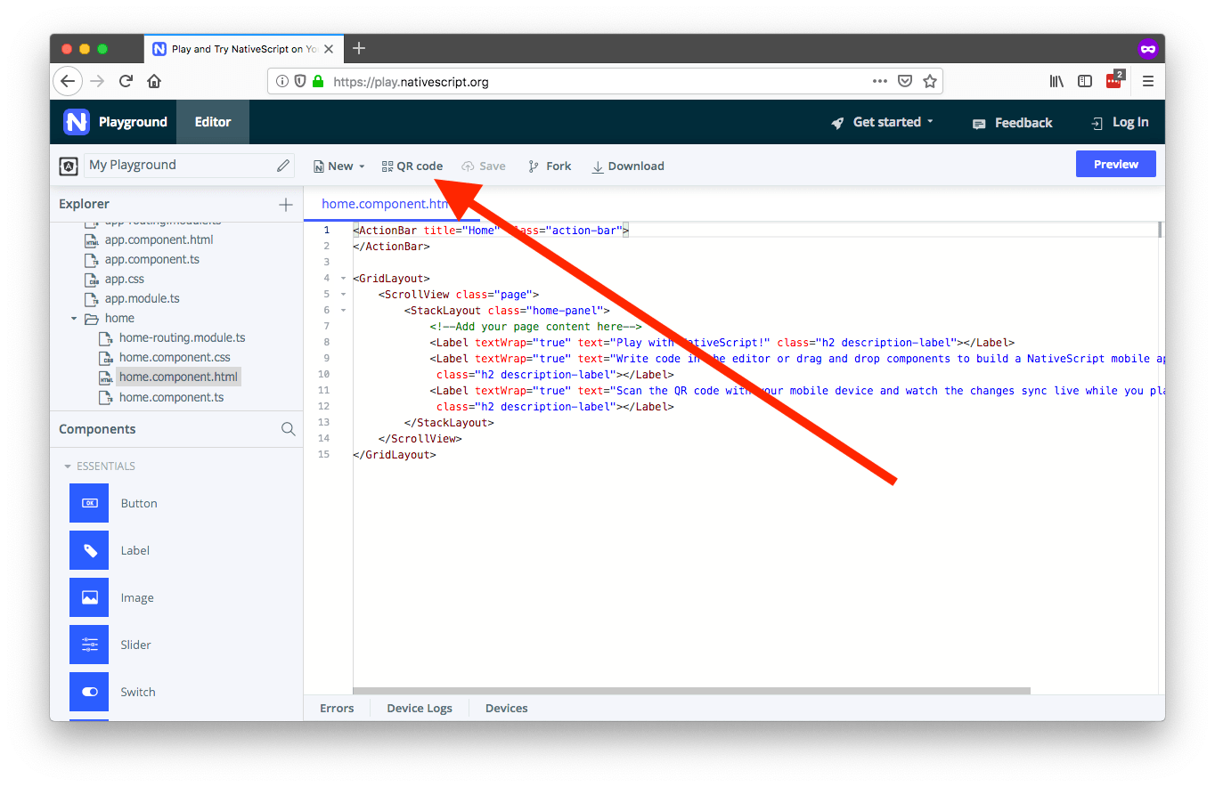

Once you have those two apps installed on your device and are ready to go, open the NativeScript Playground app on your device and tap the Scan QR code button.
Next, in your browser, find and click the QR code button (shown in the screenshot below). This brings up a QR code that you can scan using the Playground app on your device.

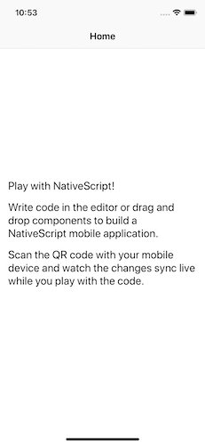

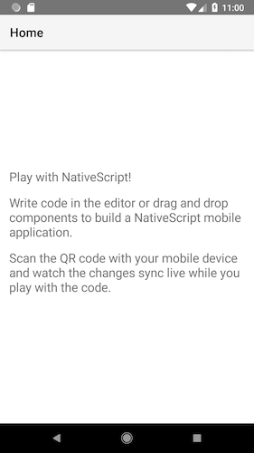

After you scan the QR code, you should see the following UI on your iOS or Android device.

If you’d like, you can experiment by changing the default app’s code in the Playground environment. As soon as you save changes, your device will refresh and you’ll be able to see your updates in action right away.

The first API you need to use is Kinvey.init(), which is the method that makes the connection from your NativeScript frontend to your Kinvey backend. Remember the code snippet you copied during the Kinvey sign-up process earlier? That code is a call to Kinvey.init() with the values you need to make the connection. It looked like this but it included your appKey and appSecret values:
Kinvey.init({

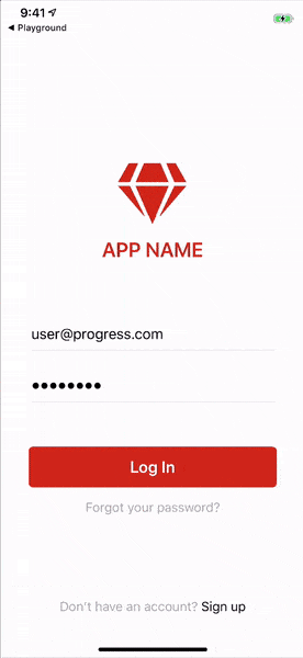

That being said, personally I like starting from a more complete app template that has a bit of scaffolding to make my life easier. My personal favorite starting point for NativeScript and Kinvey apps is the “Good-Looking Login Form” example from the NativeScript Marketplace’s code sample listing.

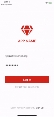

It’s a simple app, but it has a pre-built, Kinvey-based login form, as well as some of the basic setup necessary to build multi-page NativeScript apps.
Therefore, to follow along with this article, go ahead open the login form sample in your browser, and scan that app’s QR code on your device.

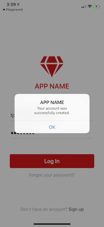

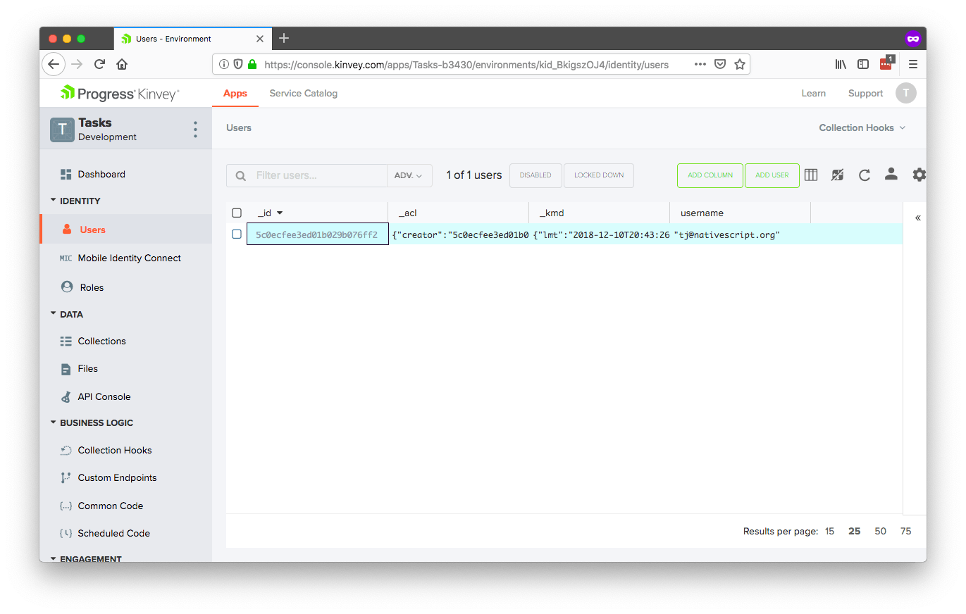

To test it, open your app on your device, tap "Sign Up," and register a new user. After you do, you should see a screen that looks like this.

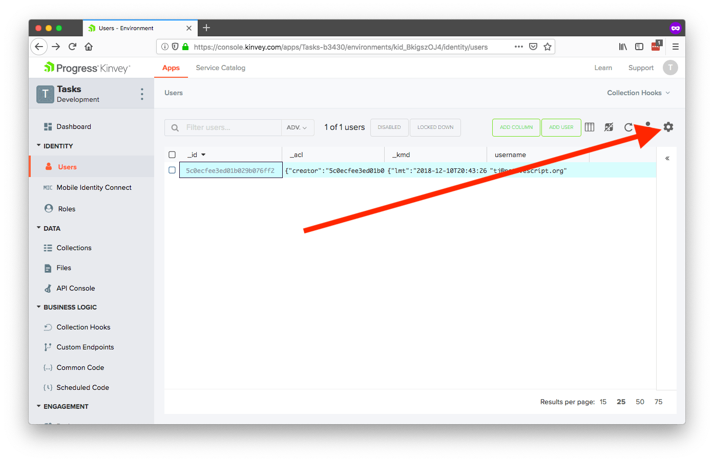

To confirm the registration worked, head to the Kinvey Console, and click the Users option in the navigation. Here, you should see the new user you just registered.

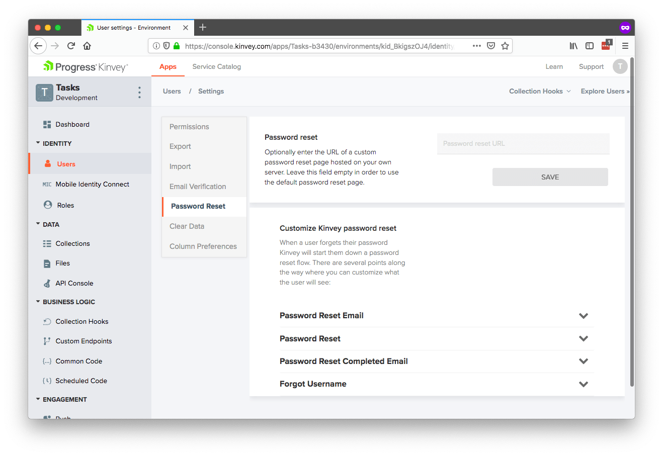

There are a few things you can do to customize how user management for your apps works. To see a few of them, head to the user settings in Console using the button shown in the screenshot below.
On the Email Verification portion of the settings, you can control whether users need to verify their email addresses before logging in and customize the emails Kinvey will send out on your behalf.
On the Password Reset portion of the settings you can similarly configure your password reset processes, or just let Kinvey take care of everything for you.

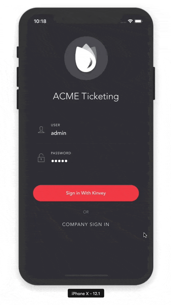

While all of this is functionality is powerful, perhaps Kinvey’s most powerful feature is its Mobile Identity Connect, which allows you to connect to a wide variety of existing authentication providers, such as LDAP, Active Directory, Facebook, or really, any provider that supports common protocols like SAML, OpenID or OAuth.
A full in-depth discussion of Mobile Identity Connect is out of the scope of this article, but if you’re interested, check out Kinvey’s documentation on setting up MIC or this tutorial by Brian Rinaldi. When you’re done, you’ll be able to leverage your existing auth provider directly in your apps. For example, here’s what the workflow looks like with an Active Directory setup.

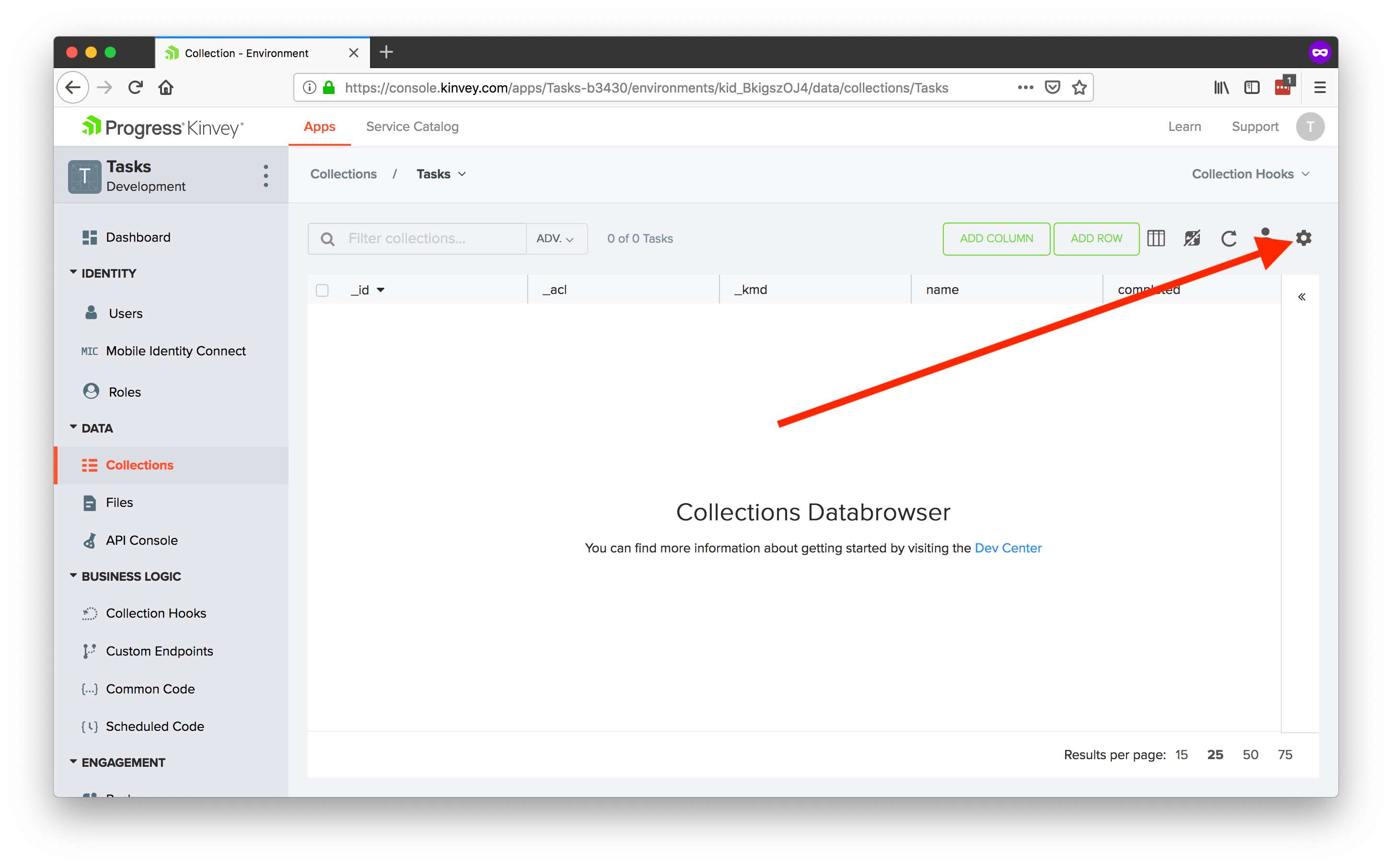

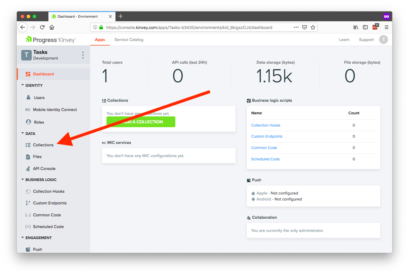

In Kinvey the building blocks for working with data are called Collections, and you can find yours in the Kinvey Console by tapping on the Collections link shown in the screenshot below.

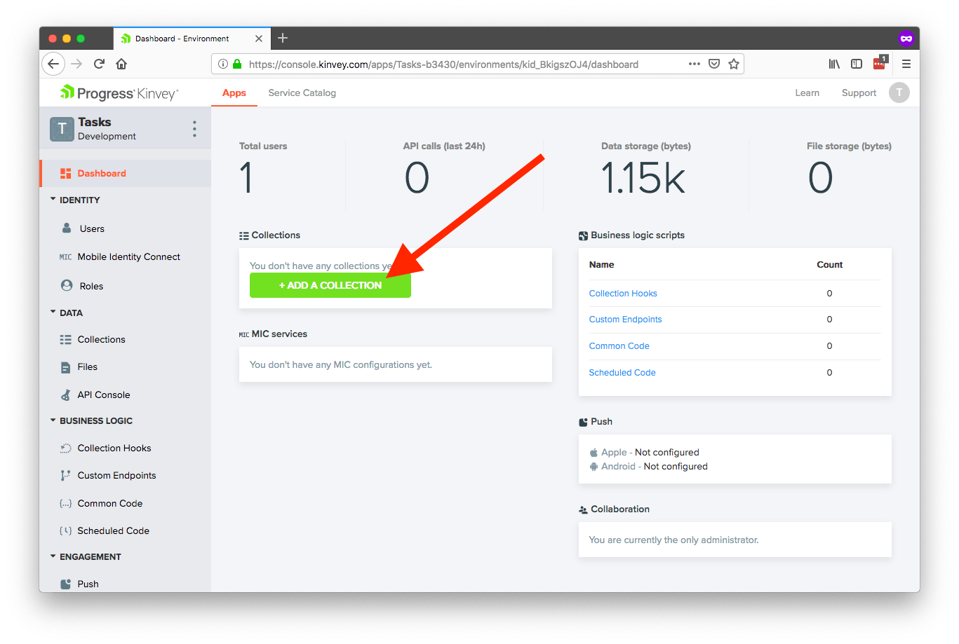

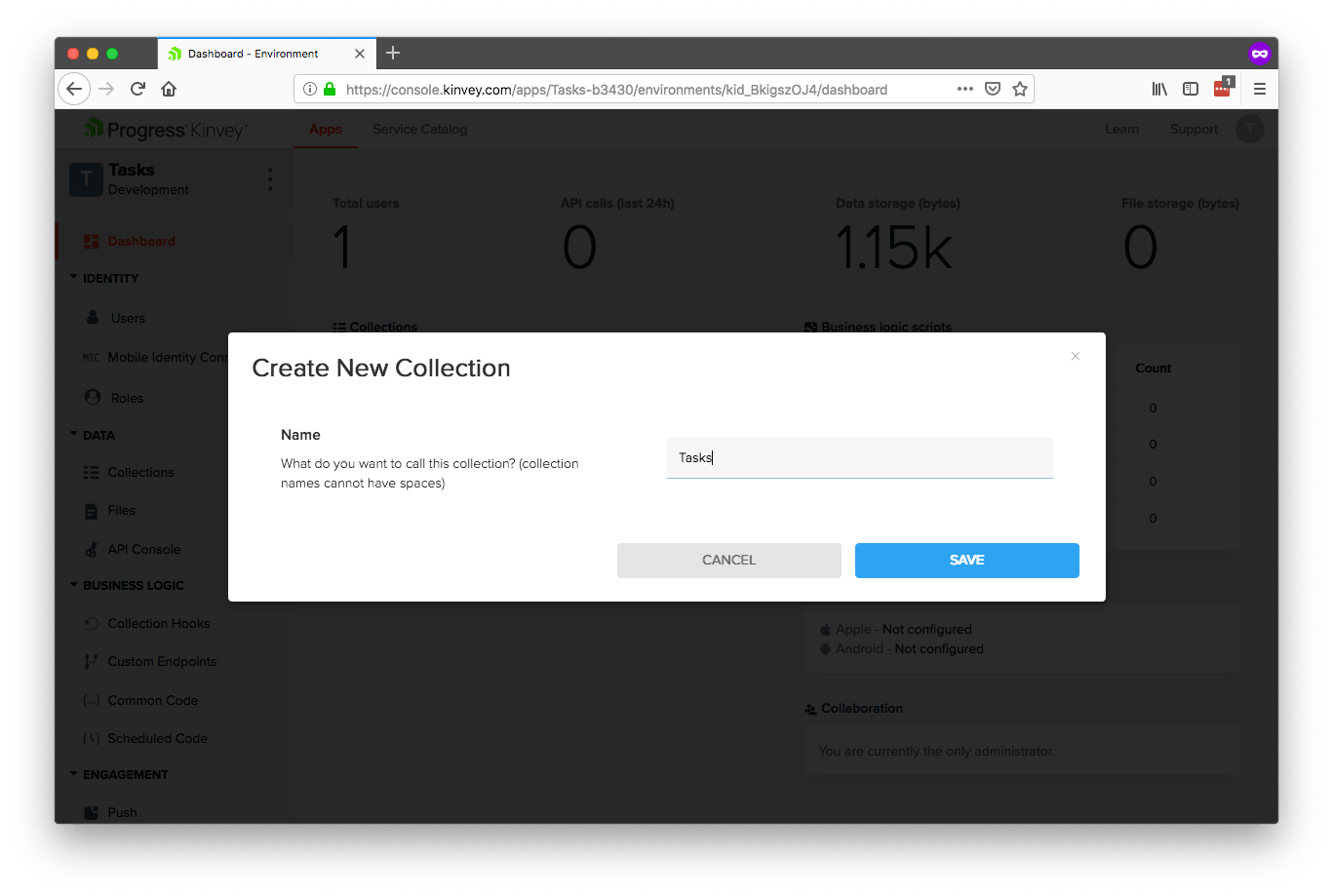

To start working with data you need to create collections, so let’s do just that by clicking the Add a Collection button.
Give your collection a name (use “Tasks” if you want to follow along with this article), and then tap Save.

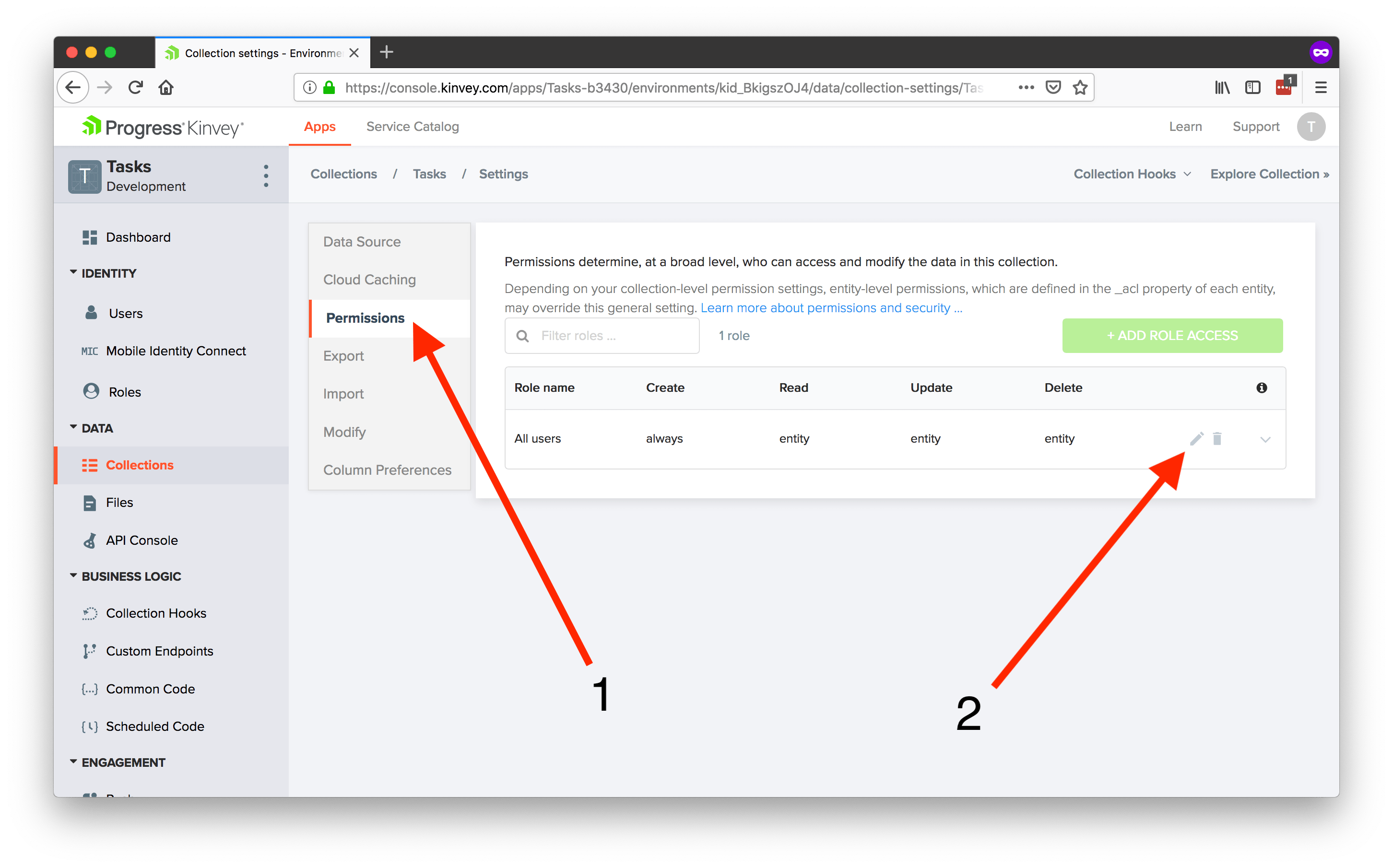

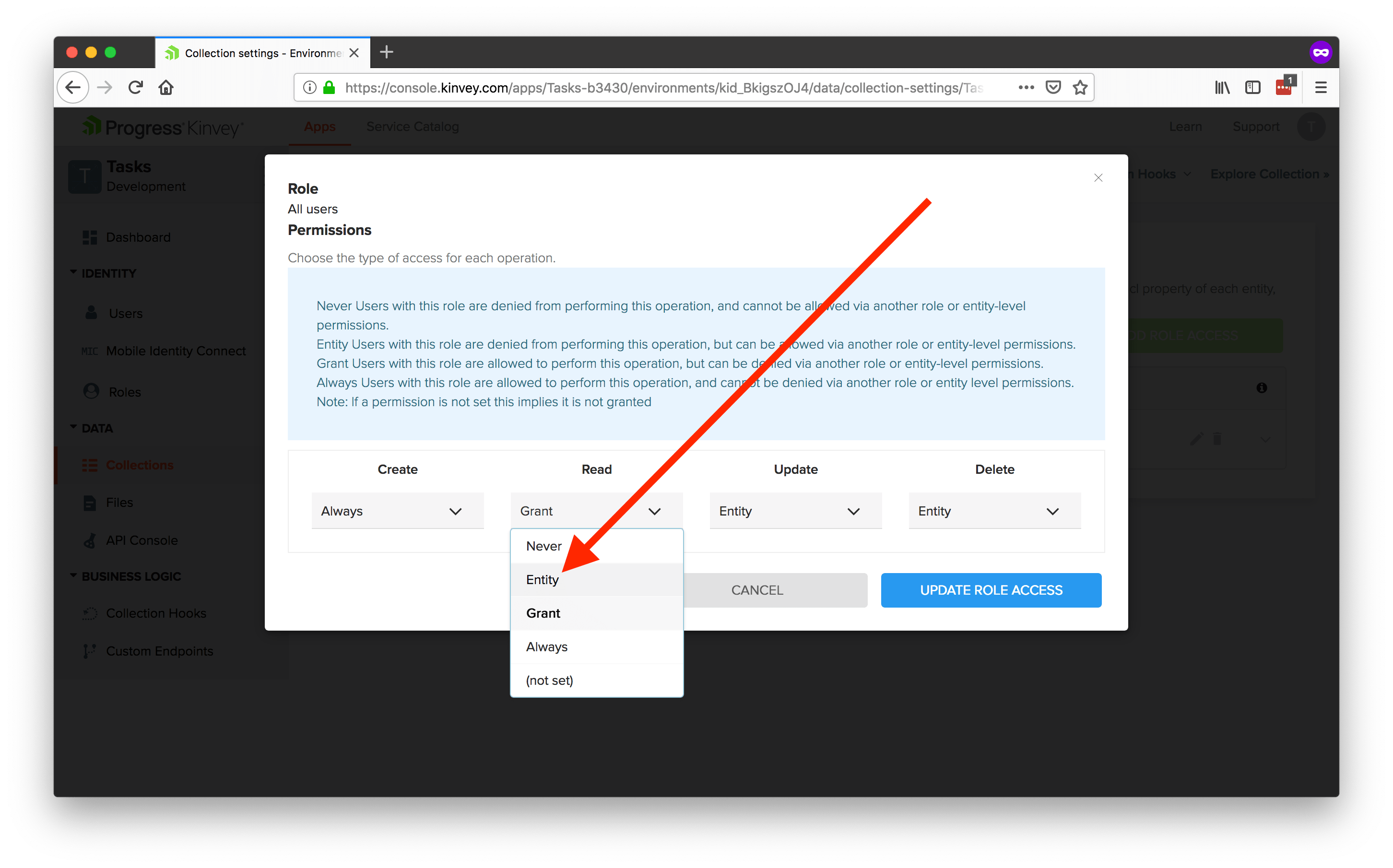

As one last step before we use this collection, let’s configure its permissions. Kinvey offers a robust set of role-based permissions that determine which users are able to access collections, and also what actions they’re allowed to take on that data. To enter this configuration for your new collection, find and click the gear icon in the Kinvey Console UI (see screenshot below).
On the following screen, first click the permissions menu option, and then the pencil that allows you to change your collection’s default permissions.
On this screen, you can view and change your new collection’s permissions for creating, reading, updating and deleting. Find the read dropdown, change its value from Grant to Entity, and then click the Update Role Access button. This makes it so that users can only read tasks that they created, and not other users tasks.
TIP: You can read a detailed write up on exactly how access control works in Kinvey in the Kinvey docs.

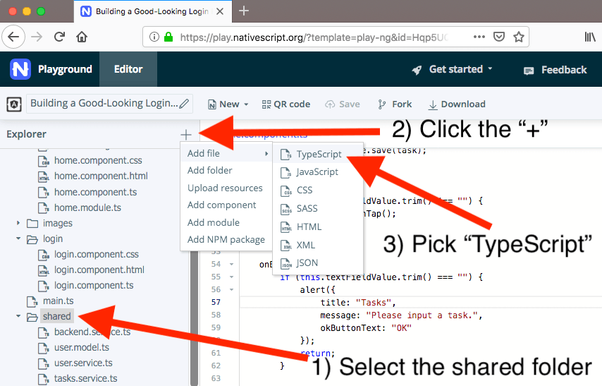

There are a few changes you need to make to use your new collection. Start by creating a new tasks.service.ts file in your app’s shared folder. In Playground, you can do this by giving focus, to the shared folder, clicking the + button in the explorer, and selecting Add File and then TypeScript.
Paste the following code into your new tasks.service.ts file, which creates a simple service for interacting with your Tasks collection using the Kinvey SDK.

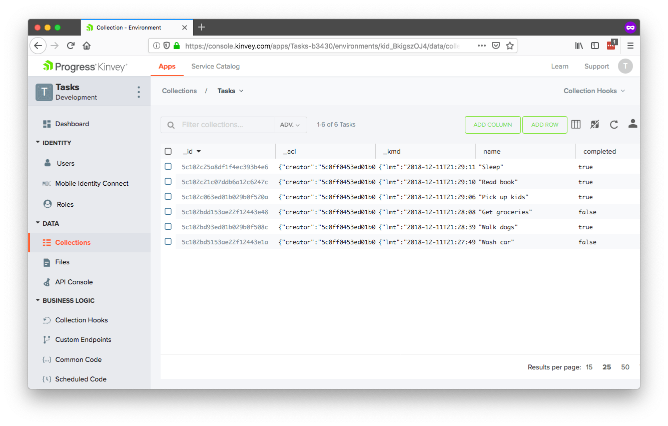

The code that interacts with your new service is pretty straightforward though. To see them, make note of the call to tasksService.get() when your component loads, and the call to tasksService.save() when it chooses to add a new task.
To define the UI for this app, open your home.component.html file, and replace its contents with the following markup, which builds a list UI for working with your tasks collection.

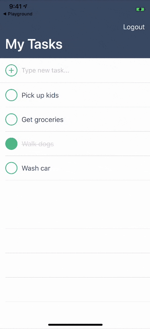

And finally, so that this app looks polished, paste the following code into your home.component.css file, which styles the UI controls you just added.
ActionBar {
background-color: #35495E;
ActionItem {

There are a few different ways to do this, but the easiest—and the one we’ll use for this article—is NativeScript Playground. NativeScript Playground is a browser-based environment for developing NativeScript apps without installing any local dependencies. All you need is an iOS or Android device.
NOTE: If you plan to submit apps to the iOS App Store or Google Play, you’ll eventually need to set up a local NativeScript environment using either the NativeScript CLI or NativeScript Sidekick. But Playground has everything you need to get started, and we highly recommend using it when you’re first learning NativeScript and Kinvey.
To start developing in Playground, you need to download and install two apps on an iOS or Android device—NativeScript Playground and NativeScript Preview.
You can find the apps by searching for “NativeScript Playground” and “NativeScript Preview” in the iOS App Store or Google Play, or by using the links below.
TIP: You can connect multiple devices to a NativeScript Playground app and develop on them simultaneously. To do so, just install the NativeScript Playground and NativeScript Preview apps on multiple devices and scan the QR code on all of them.
And with that, you’re ready to start developing NativeScript apps!

Authorization and user management are often some of the more fun requirements of your average app, but Kinvey makes them easy. In fact, the sample app you’re using already has a fully functional user management system.
NOTE: You can view the source of the above application on GitHub if you’re looking for a high-quality NativeScript and Kinvey sample to reference.
On the next screen you’ll see a UI allows you to select between Kinvey’s built-in cloud-based data store, and Kinvey’s data connectors, which allow you to connect to data you already have.
Kinvey data connectors are known as RapidData, and they’re worth checking out if you have existing data in SharePoint, SQL Server, Salesforce, SAP or if you have existing REST APIs. For the purposes of this article, we’ll keep things simple and use Kinvey’s built-in data for the new “Tasks” collection you just started.
And with that, your collection is now setup and ready to go. In the next step, let’s look at how you can use your new collection in your app.
Step 6: Use Your Data
Like with authentication, using Kinvey data in NativeScript apps is as easy as making a few simple calls to the Kinvey SDK. To see this, head back to your app in NativeScript Playground.

Save all these changes, and you should now see the following UI on your device for managing tasks.
And what’s cool is that if you look at your Kinvey backend, you’ll see that all your changes are saved there as well—even if you used Kinvey’s RapidData to connect to an existing data store like Salesforce or SQL Server.
Cool, huh? Starting with a simple to-do list app like this is a great way to learn what Kinvey and NativeScript can do. With that in mind, here are a few features you could try adding to this sample as a learning exercise.

- Editing—Allow users to do inline edits of the text of each item in the list.
- Activity Indicators—Use the NativeScript ActivityIndicator component to show users when their data is loading.
- Offline—Make the form work even when users are offline. Kinvey makes implementing this functionality trivial; check out the Kinvey documentation on the topic.
If you got lost at all during this section, here’s a complete version of the sample app in Playground you can refer to.
