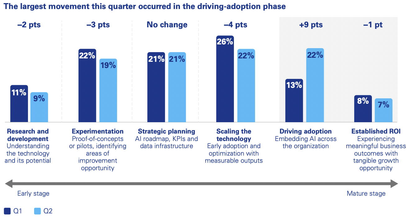

AI is moving from pilots into everyday work pretty quickly. KPMG found that the share of organizations where AI had become part of everyday work rose from 13% in Q1 to 22% in Q2 2026.
The largest movement this quarter occurred in the driving adoption phase, from Q1 to Q2: Research and development 11 to 9%, experimentation 22 to 19%, strategic planning 21 to 21, scaling the technology 26 to 22, driving adoption 13 to 22, established ROI 8 to 7
Source: KPMG

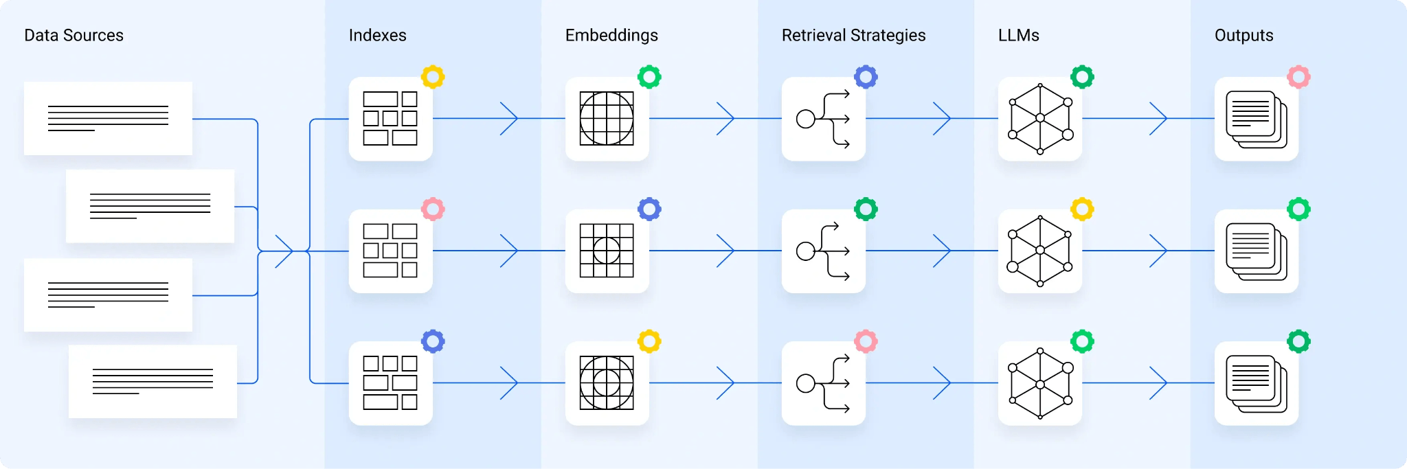

That kind of repeated testing is also what Progress Prompt & RAG Labs are built for. Teams can experiment with prompts, models and retrieval configurations before changes reach production, while REMi can continue evaluating the quality of the RAG experience afterward.
RAG Diagram: Data sources – indexes – embeddings – retrieval strategies – LLMs – outputs
For teams using Progress Sitefinity AI Search, the same principle applies. Start with the questions people are likely to ask, decide what a good answer should look like, and keep that test set around as the content and search experience evolve.
