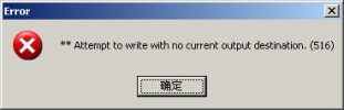

Our license allows total 32 users count on-line, for that our users always stay in the system with doing nothing or doing some simply inquiry occasionally, so our system often raise warning message, like "license count is full....",I know most of them only are using a inquiry function in our system, but they must login in mfg/pro first and then they can use the inquiry function, It is a waste of license-count, I am only a programmer, I think I can write a inquiry program instead of the old inquiry function of our system and make it run independently out of mfg/pro.
For these reasons, I try to write a application with progress 4gl ,with which we can write some codes and make it run as same as make it run in Procedure Editor of Progress. I know I can use the cmmand:
"PROWIN32.EXE-pf c:\fbTS02.pf -ininame c:\progress.bch -b -p test.p" ,
test.p:
output to c:\abc.txt.
Find frist pt_mstr no-lock.
Disp pt_part pt_desc .
Output close.
But the code in test.p must make my DISPLAY output to a File, If not deinfe “output to c:\abc.txt.”, progress will raise a error message, as the following image.
of couse , I can purchase more lincese count or purchase Cyberquery for solving these problem,but I want to understand how can we use progres 4gl to write a program that owns a main interface like a normal MIS system.
