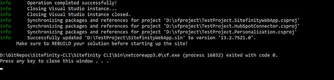

An important note to make here is that you need to rebuild your project once the CLI has finished with the upgrade process. Now, you can run the application, which will trigger an update of both the database and the config files.
That’s it then, all you need to do is run the Upgrade command, sit back and watch it do its magic. Respond to the prompts, if any, keep the project under source control and don’t close Visual Studio unless—for whatever reason—you need to cancel the upgrade. Here go the key benefits of upgrading via CLI:
