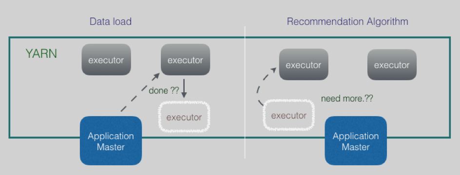

Based on the –spark.executor.memory, –spark.executor.cores, –spark.tasks.cpus and total number of tasks, the number of executors required will be calculated. Once the number of executors are calculated, the same can be requested from the Application Master and in turn communicate with the YARN Resource Manager to request for desired number of containers to be allocated so that executors are run. This process happens in batches when there are pending tasks for spark.dynamicAllocation.schedulerBacklogTimeout seconds, and then triggered again every spark.dynamicAllocation.sustainedSchedulerBacklogTimeout seconds. Once the execution is done, the containers are released and the executors who are idle for spark.dynamicAllocation.executorIdleTimeout are shutdown explicitly by the Application Master, so that other running applications can request for more executors.

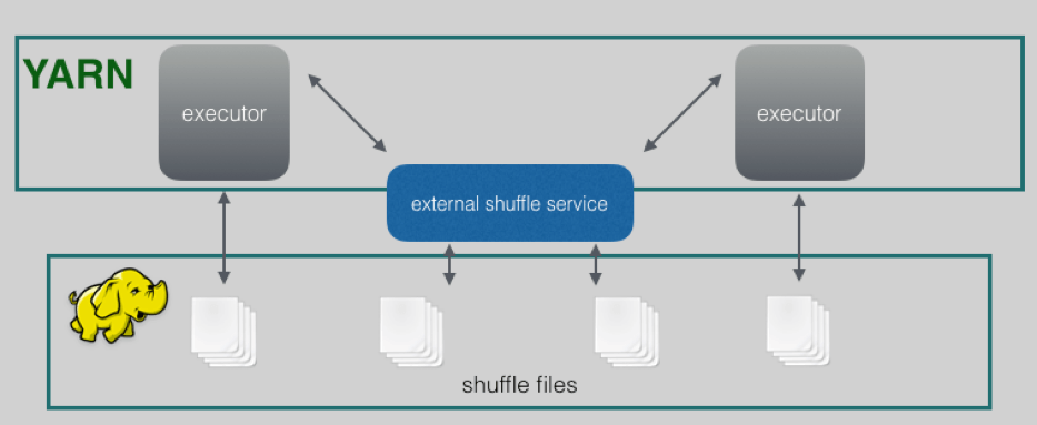

- Decommissioning of executors might happen when the application is still running. Hence we need someone to maintain the state. Important use case for this will be during shuffle phase, once the executor writes the shuffle output to the disk, the executor might be removed. We need someone to serve the shuffle output to other executors. The External shuffle service which was enabled, will actually solve this problem.
External Shuffle Service: A long running process that runs on each node independent of the application, serves the shuffle files to other executors, which means any executor’s shuffle state will be served even after its removal.

Knowing the rich set of configurations, with the combination of spark.dynamicAllocation.initialExecutors, spark.dynamicAllocation.maxExecutors, spark.dynamicAllocation.minExecutors we can divide the cluster resources among the applications by defining specific Spark Config properties for each application so that resources for the applications are not overlapped and continue to serve in parallel.
