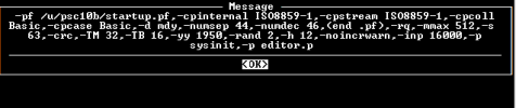

You have the -rq option in your startup.... that is to make the client support Results style only. Which means compile read only code.
You have to remove that to be able to compile programs that update data.
TheMadDBA
Active Member
It isn't in your startup.pf (you can tell by the screen shot you supplied. Everything after the (end .pf) is in the script that you are launching. That will have to be edited or you will have to use another script that doesn't include that parameter.
