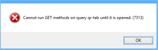

    Thanks for your help. I don´t have a QUERY-PREPARE in the .p file. So I pass the handler to the class but I can´t use the query or get the data, this is my code in the .p:
    DEFINE VARIABLE a AS CLASS testeaj.
    a = NEW testeaj(brw-tab:HANDLE).
    If I do this in the class It has a error because it doesn´t run a Get method on query:
    HQueryBD = brw-query:QUERY.
    HQueryBD:GET-FIRST ().
    DO WHILE NOT HQueryBD:QUERY-OFF-END:
    MESSAGE "In"
    VIEW-AS ALERT-BOX.
    END.
    This is the error:

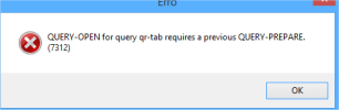

    If I put and QUERY-OPEN It ask me for a QUERY-PREPARE

  5. Osborne
    Osborne Active Member
    Ah, if the query is not being opened in the .p file then the class needs to open it. Try something like the following:

  6. Miguel Neves
    Miguel Neves New Member
    Hi, Osborne.
    Thx for your help.
    I put the code in the .p and the other in the class, but it has the next errors:
    Any idea? because in the class I don´t have the query string. I try to pass it but I couldn´t get it in the class
    thx a lot.
  7. Osborne
    Sorry, typo error on my part as missed out the EACH. In the .p the extra line required should be:
    Code (progress):
    1. brw-tab:QUERY:QUERY-PREPARE("FOR EACH tg_pais NO-LOCK").
